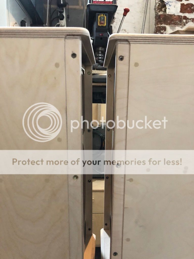

I've recently been build a batch of speakers enclosures.
All machining was done with a hand router and templates for the recesses and cut outs.
prototype complete
8 units assembled
Threaded inserts and tee nuts were installed prior to assembly as well as the ports, the handle back, inside of the handles were sprayed black, screw and glued.
Will be spraying them with a paint called Warnex, its very thick and spayed with a pressure pot sprayer.
It will give a textured, splatter finish with a satin appearance which is hard wearing.

They are 2 way cabinets the rectangular hole is for the HF horn and round hole for a 12" driver.
I've got the drivers from Lean business they are BMS Neo drivers.
The enclosure will be line with wadding.
With extremely bass heavy music yes some port noise will occur if you don't use a high pass filter to roll the low end off.
I'll be using them as stage monitors so extreme low end content will not bee needed, when you as a PA system the will have subs underneath them taking care of the low end.
