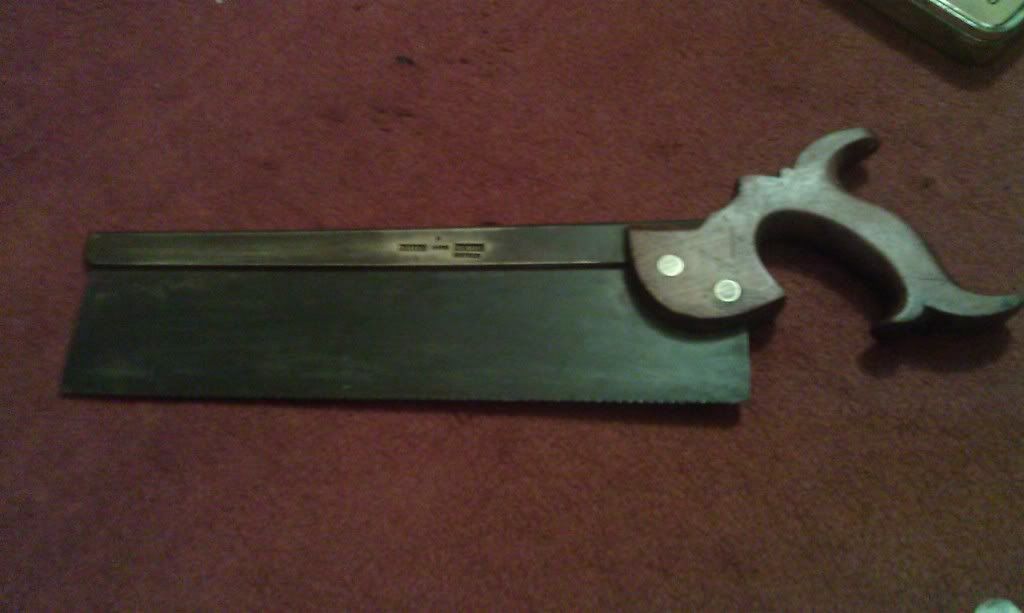

Hi, Jim
Here is mine,
Its had more sharpenings than yours,
Made by, mmmm difficult to make out,
Bit better,
Better still,
Drabble and Saunderson London, any one have any info on D&S?
And do you think Pedder can do any thing with it :wink:
Pete
Hi Pete
Nice saw indeed and as you say...shallow steel with the same plain bit on the tail end.
There is another Hill one just like mine on Best Thing Saws
If you look further down the page you can click to a larger picture.
They only wanted $59 for it but it did have a kink in the steel so I think that one might have proven quite difficult to sort out. Mine is as straight as a die...something I think adds to the case for restoration.
I think only Pedder can say if Pedder can restore yours...as with mine.
I have PMd him to ask him to visit the thread and comment.
Just a reminder of his skills with the Sorby.....
Impressive indeed eh!? 8)
Jim
